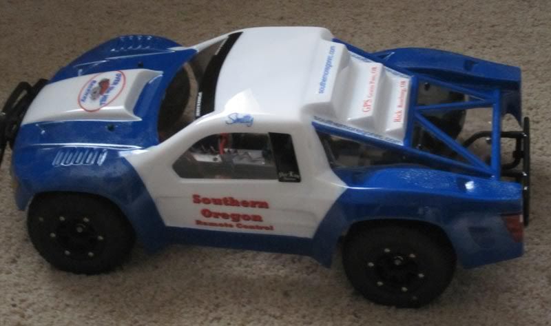

    Almost done.
    Just need to do the cutouts.
    I like the paint job Smitty.  I was considering a two-tone job like that also.  Can you tell us what colors you used?  Paint brand and color name?
  19. smitty
    Truthfully, I'm not proud of this paint job.
    I'll fill in the details in awhile.
    Ok, where did I leave off...
    Oh yeah, this was the paint job from #@$$!
    The FloTek body has very little flat areas.
    All of the louvers make it a masking nightmare.
    Then factor in the decals...
    I tried them reversed on the inside and settled for them on the outside.
    Due to the opacity (word?) of the label stock they worked better with the white background.
    Don't forget about the difficulty with the airbrush.
    I'm just glad it's over.
    Will I paint another body?      maybe.
    If I do, I'll use lexan rattle cans.
    Colors and Paint:
    This was a real mixed bag.
    I started out using water based acrylic white on the hood scoop. Two or three coats before the airbrush and I decided to part ways.
    I had a real difficult time deciding on the two tone scheme. I finally settled on where the tape led me.
    I picked up a can of plactra lexan white, but was too cheap to pay $6+ for the blue.
    This stuff laid down really well. Note: must use this outdoors, extremely odoriferous.
    STINKS!
    By the time I got to the final blue (Rust-oleum, Painter's Touch Deep Blue) the weather had turned too cold for a successful result. The resultant crackle finish actually looks pretty cool, except it's not uniform.
    One feature that I do like is the clear panels on the rear.
    I'd like to try a matte black with the clear panels.
    When all said and done, after a few battery packs and some road rash, it will look just fine.
  20. highlandcrawler
