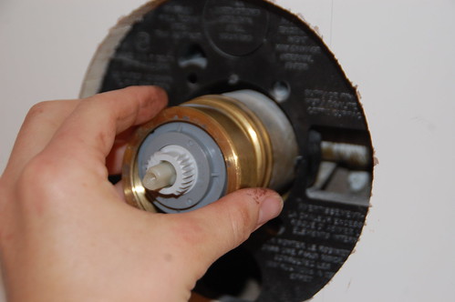

    Sitting here waiting for Home Depot to call back is the only reason I am sitting here typing this. Tried to fix a leaky shower valve in my house, should be a 5 minute job right?
    Couldn't figure how the damn thing comes apart, the obvious choice is unscrew the ring, won't unscrew. Searched Google, yeah it does unscrew, but it is infamous/notorious for never coming off, a pipe wrench will distort it, pliers will crush it, need a strap wrench and that will only work if it is not frozen on there. 99/100 are frozen, but you can NOT turn it too hard or you WILL RIP THE PIPES APART IN YOUR WALL! Every plumber in the world is on a forum somewhere ranting about this stupid design.
    Now I need a new ring, have bent it beyond reuse, and it is still frozen on there. Have to get a new ring ready first, then go buy a Dremel and make a slit, but don't hurt the threads, and don't get it hot (you will ruin the $65.00 plastic cartridge), then crack it with a screwdriver and spray it with oil to get it loose enough to spin off.
    I am 4 hours and $100.00 into a 5 minute job to replace a .24 cent rubber seal..............

    Showers are always a pain especially if they have a "MOEN" type valve and cartridge.  Even worse is that showers never have any reasonable access to the pipes so you might end up having to punch through drywall or remove a composite shower or tiles.
  6. Pelagic Pilot
    I learned in about 120 seconds of Google searching that the part I needed is called a "Brass Bonnet Nut" which is a unique term to a Delta shower control valve, also that these freeze on and need cutting off sometimes, and that it happens all over the world. Every hardware store person I talked to on the phone had no idea what I was talking about. They sell this stuff and did not have 2 minutes of knowledge under thier belt.
